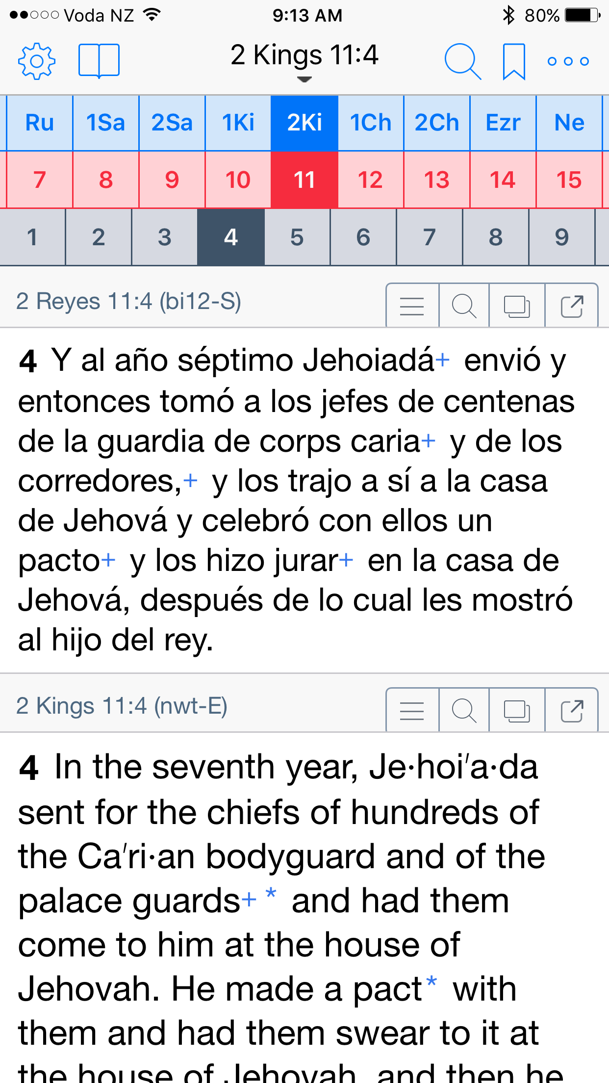

    @Raul8a - I apologise that it took me so long to actually play with this. I took a couple of days off from the app to keep my sanity :)
    Now that I have actually experimented with your setup and re-read your posts I can see that what you mean is that:
    1) This is your Web Search configuration:
    Code:
    http://wol.jw.org/es/wol/b/r4/lp-s/Rbi8/S/1987/%b/%c#v=%v
    2) And this is what it gets turned into when you look up 2 Kings 11:4:
    Code:
    http://wol.jw.org/es/wol/b/r4/lp-s/Rbi8/S/1987/12/11%23v=4
    So yes - the issue is isolated to the # being turned into %23 - which is the URL encoded value for #. I will certainly look further into this and resolve any issue here.
    However. Stepping back from your question, my bigger question is why you would ever set this up as a Web Search? Why not just download the Spanish NWT EPUB file? And then you can read it in the app?
    Please see the attached screenshot of the exact same scripture open inside the app in Spanish...

    Thank you for respond my post. The reason to use the configuration is because if I open the right panel with the verse selected, I can see the index comment for specific verse.
    I'm not use the configuration to search a verse.
    If I select Index search using: http://wol.jw.org/es/wol/d/r4/lp-s/1200270002, just appear the book and I need to search the chapter and verse. But think in Psalm 119 :) The other hand, I will go directoy to verse, and open the right panel and I can see the comments...
    I have fixed this ready for the next update.
