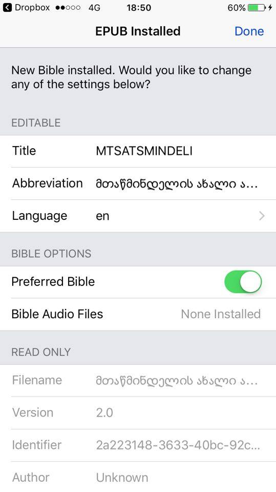

    I'm attaching the screen shots how they look in my equipd app and please see it you might get full picture of the problem:

    Hi Guri,
    Thanks for clarifying you got the epub from somewhere else. I believe that my above explanations already explain that Equipd Bible only loads "compatible" bibles. I will post this content here once more:
    This epub is not compatible sorry.
