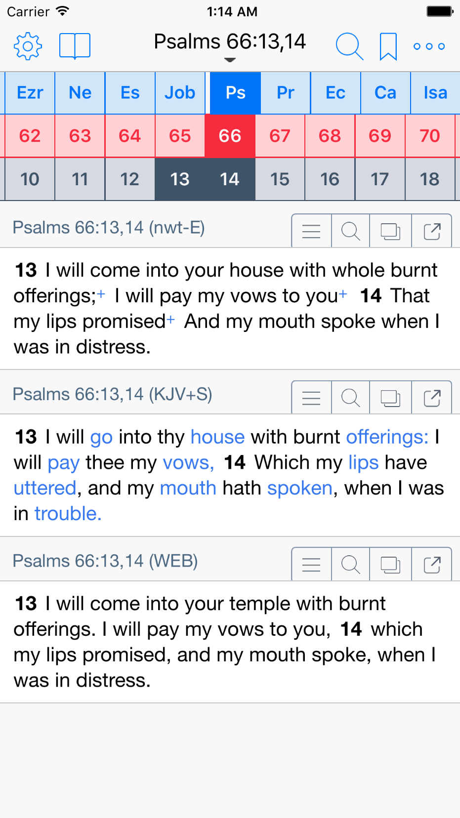

    I have managed to improve this. See screenshot below.
    Regarding the + sign not appearing in iBooks etc. Of course. The + sign is for cross-references which are not in the original EPUB file. The Equipd Bible app is "supplementing" the EPUB with this additional information. Support for supplementary cross-references was initially added in version 3.0 which you can read about here.

    That is a great improvement, Matt, thanks. The cross-references which were linked by the misplaced + sign have disappeared, though. Is there a way of re-instating them?
    @Bohemian Please compare to here:
    http://wol.jw.org/en/wol/bl/r1/lp-e?q=Psalm 66:13
    The issue was that the cross-reference was for the word "you". And it matched that incorrectly to the "you" found inside "your" - which is why you got "you+r". But it should have matched it to the word "you" found at the end of the verse.
    What you see now in the screenshot is the way it should be. Make sure you are looking at the top "nwt-E" version in the screenshot - the cross-references do not apply to the KJV or WEB Bibles.
    Does that make sense? Or did I misunderstand what you meant?
