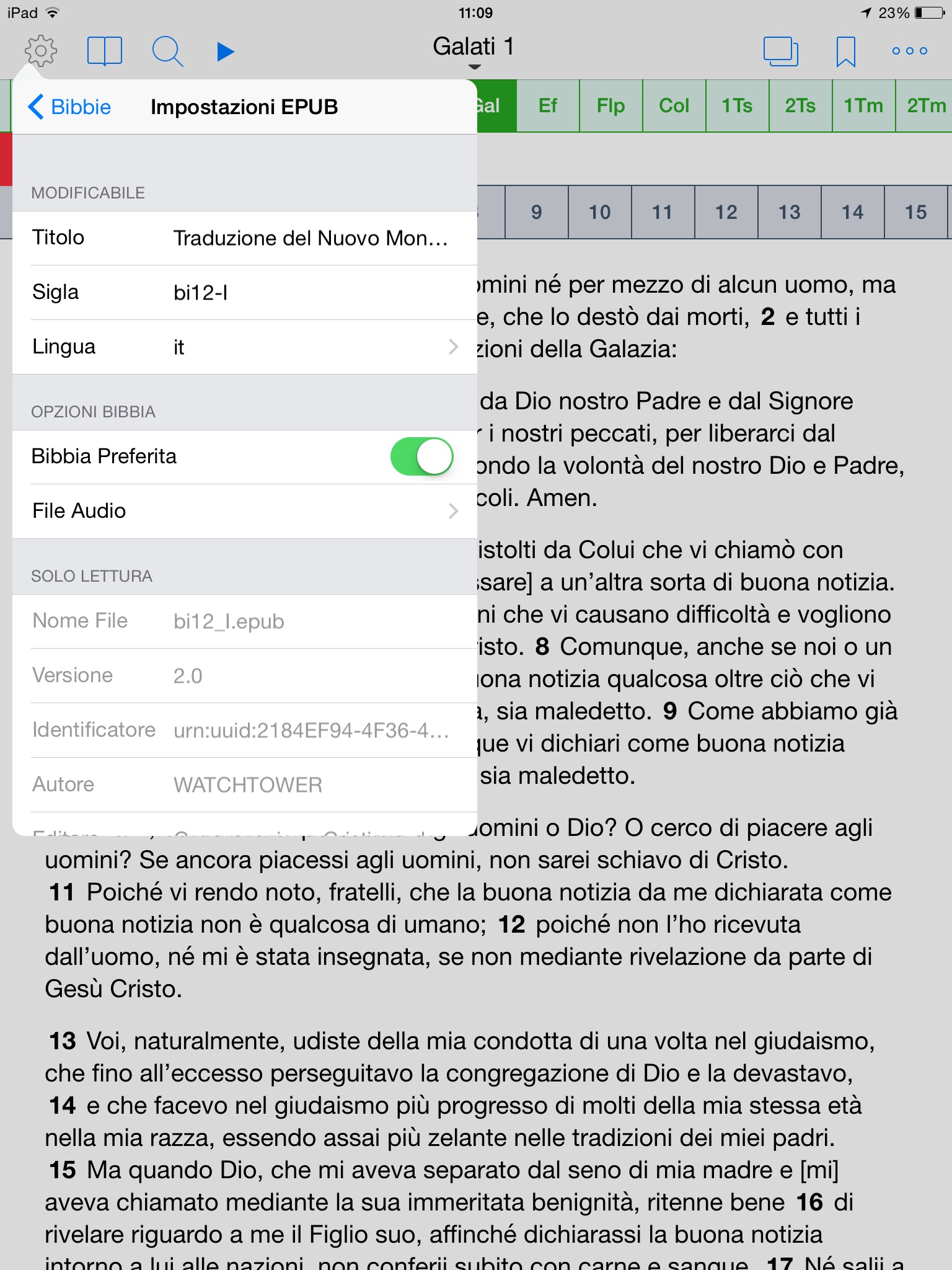

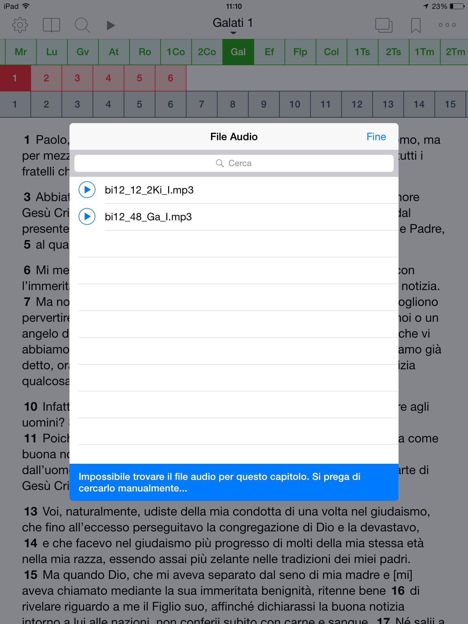

    Ciao, grazie per la veloce risposta. La Bibbia dalla quale voglio ascoltare l'audio è la TNM b12_i ePub. Quando voglio aprire manualmente il file audio, se ne esce dal programma. Di seguito ti allego degli screenshot che illustrano il procedimento che seguo.

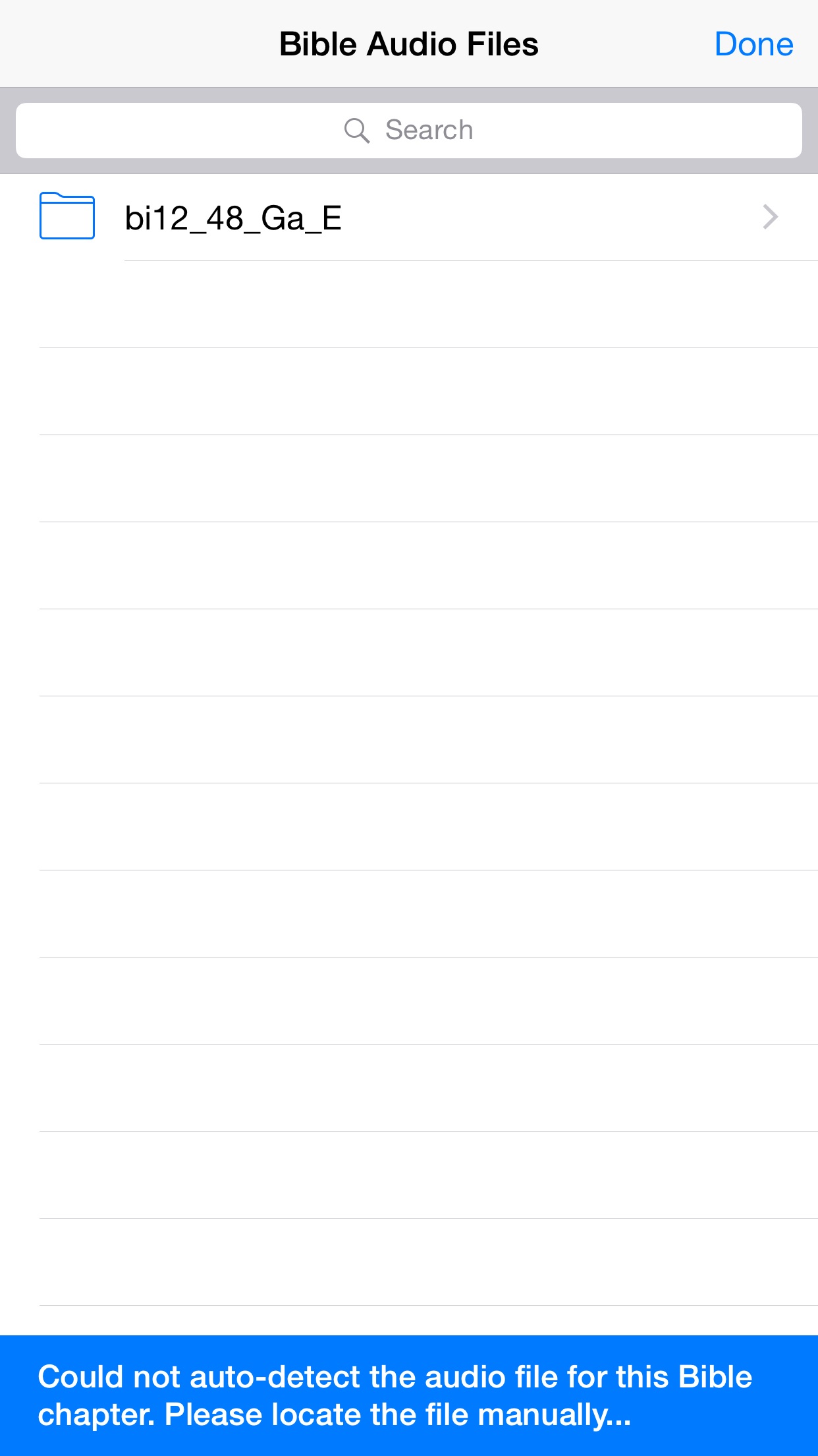

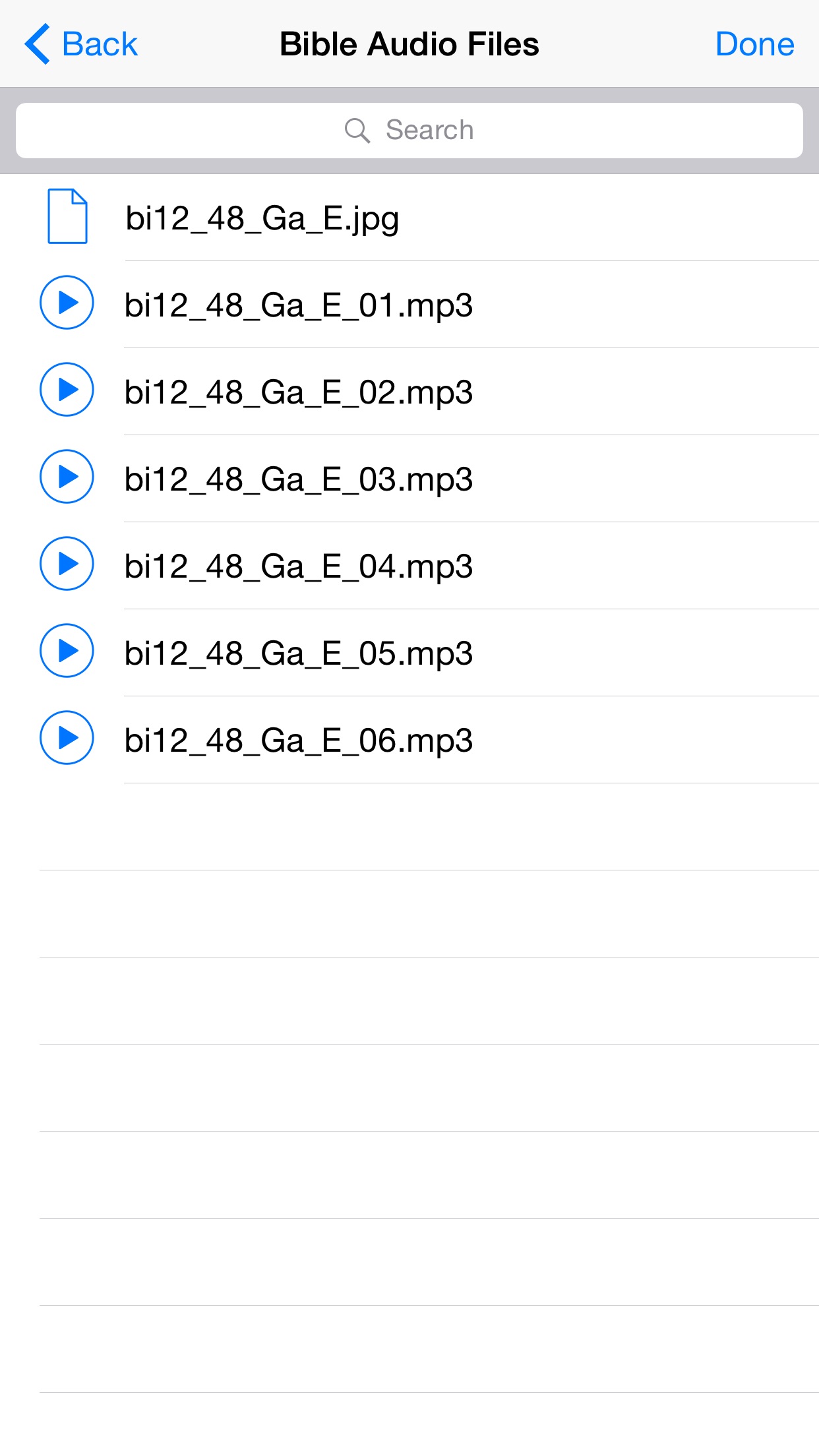

    Thanks for the screenshots and additional details. I just tried installing the ZIP audio files for the Italian bi12 and I can see that something is very different with them from the bi12 audio for English for example.
    When I download and install the MP3 audio ZIP for the book of Galatians in the English bi12 the screens show as attached below. But for the Italian audio zip it shows what you see in your screenshots. I will investigate this further to see what is different with the Italian zip - thanks for reporting the issue.
    I have located the issue with the Italian audio file. It is because the unzipped folder name has ".mp3" at the end. My code was top "loose" and assumed this was an audio file, when in fact it was a directory. Lazy coding on my part that will be fixed in the next update. In fact it now will auto-detect the audio and you will no longer need to manually select - not with Galatians anyway! :)
