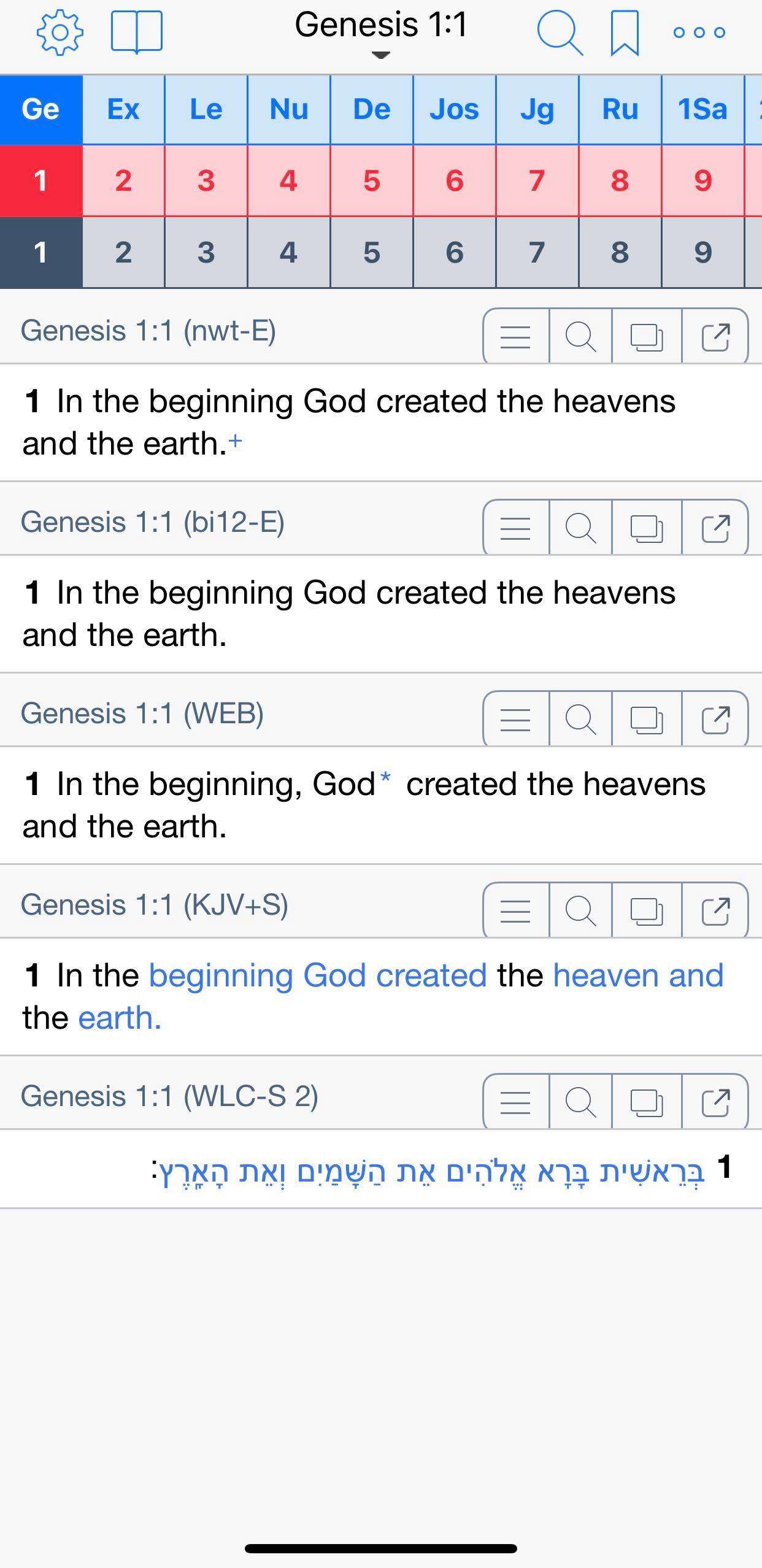

    How it looks after choosing a scripture:

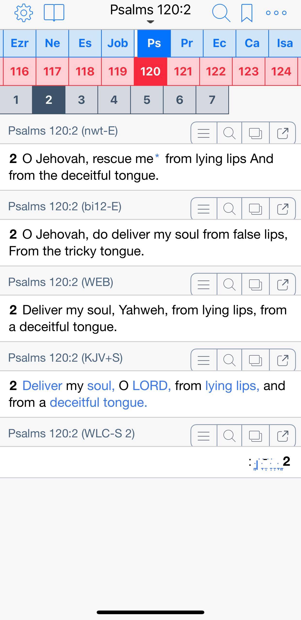

    How it looks when I select a scripture from bookmarks:

    UPDATE: the super tiny font only occurs in Psalms, regardless of bookmarks. Sorry for my earlier confusion.
    Hi @JimSpace I have looked at the issue, and as you mentioned it seems localised to Psalms.
    It is not related to how you look up the scripture, or to the font size - it is very specific to the side-by-side view where it needs to extract each verse to display. The content of the verse itself is not being extracted, which means you just end up with some odd characters and the blue dashed underline from the link to the Strong's Concordance. If you jump into the full Chapter screen you will see that the verses look fine.
    So to clarify, the issue is not with the app, but with the formatting of the EPUB file. Which was kindly created by @Gabriel over in this thread. So we will need to get him to have a look at the verses in Psalms and see if he can fix up the HTML formatting of the verses so that the app can view them properly.
